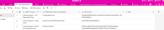

I have a main base called “SOURCE” and a second base called “CQC”. Within SOURCE I have a table called “Sites” which is shared via a Common Dataset into CQC.
Within the CQC base, some more information is added that needs to be kept separate, but there is a single piece of information that we need to sync back into SOURCE - which Sites are linked to which Registration.
I have created a second Common Dataset in CQC and added that into the SOURCE base, such that I can see that data. However I would like to automatically link the Sites table to the new table but I seem to be unable to do this.
I am aware that Linked Records do not work across Common Datasets, so I have a rollup function that is looking up all RowIDs and putting them in a column. How can I then go about linking the data all together.

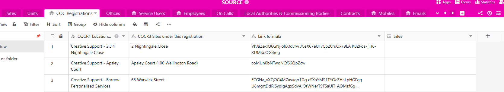

In the screenshot below I am looking to get the RowID is “Link Formula” into the linked field “Sites”
Common datasets only support unidirectional sync. That is a functional restriction.
In the screenshot, I see a link column from CQC requirements to Sites. How does that related to your statement: “However, I would like to automatically link the Sites table to the new table […]”.
