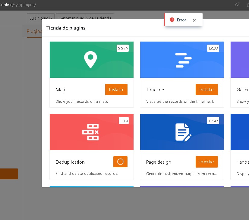

I can see the “Plugin Marketplace” and the full catalog of official plugins (see image_b7e57b.png). But, when I click “Install” for any plugin, the operation fails, and the UI displays a generic “Error” popup.

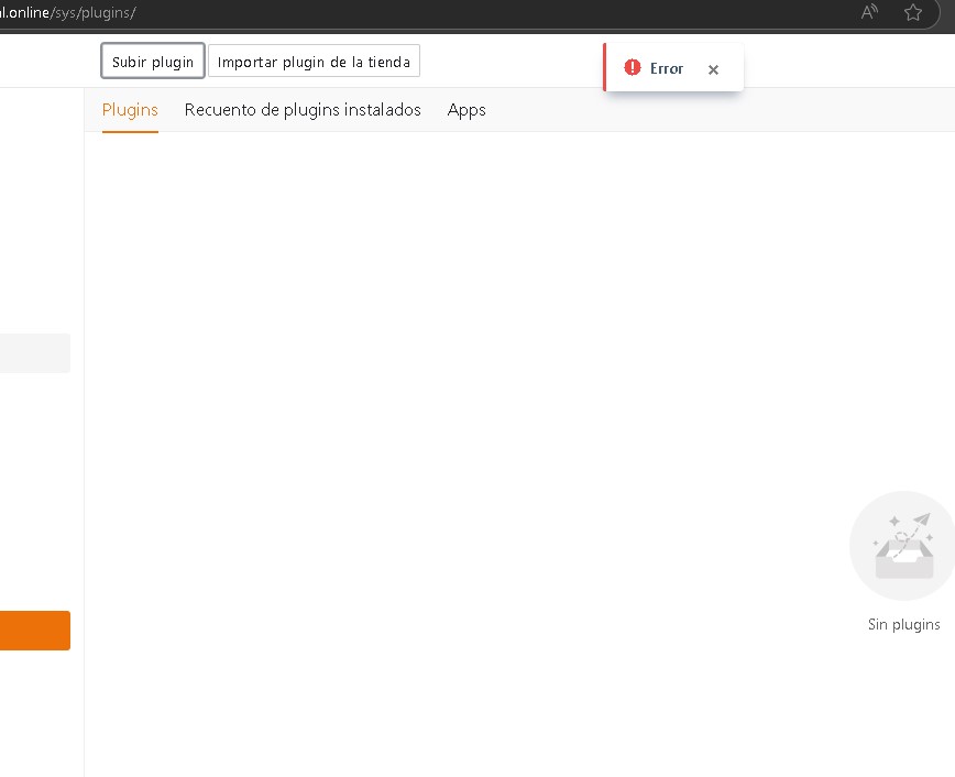

If I try to use the “Upload plugin” option from System Admin → Plugins, this operation also results in an “Error” (see subir plugins.jpg).

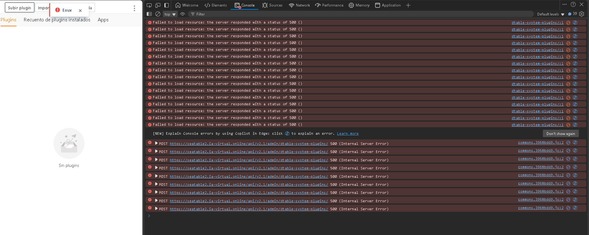

I’ve confirmed that SEATABLE_PLUGINS_REPO_ID is not set in my .env file. However, my dtable_web.log consistently shows the following traceback and pysearpc.common.SearpcError: Invalid repo id when the system attempts to access /api/v2.1/admin/dtable-system-plugins/:

Consequently, the error pysearpc.common.SearpcError: Invalid repo id for POST /api/v2.1/admin/dtable-system-plugins/ (when trying to install from the store) persists in dtable_web.log.
Manually uploading the plugin (to POST /api/v2.1/admin/plugins/upload/) continues to fail with a 500 error in the browser,
with no specific trace logged in dtable_web.log for this specific upload URL (the only Python error logged is “Invalid repository ID” for /dtable-system-plugins/).

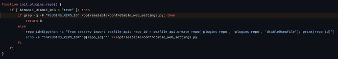

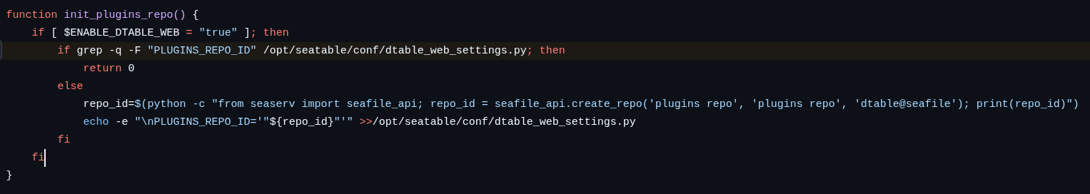

This is from the script that is executed on each start. SeaTable checks, if PLUGINS_REPO_ID exists in dtable_web_settings.py. If not, it generates a seafile library and saves the new repo id to the configuration file.
This plugin repo is used to store the plugin files and -configuration. Therefore, it is mandatory for the installation of SeaTable Plugins and explains your problems.
I installed around 100+ SeaTable Server Instances and I never had this situation before, therefore I can’t give any advice.
What I would check is your configuration of the seafile component of your SeaTable server. It seems, that it is not working correctly, and the repo can not be generated.

  • Executed the Python command used by the seatable.sh script, after ensuring internal services had stabilized: python3 -c "from seaserv import seafile_api; repo_id = seafile_api.create_repo('plugins repo', 'plugins repo', 'dtable@seafile'); print(repo_id)"
  • This successfully generated a repository ID (e.g., d7e32a76-bee0-442a-9216-db445357b76b).
  1. Manually Inserting the ID into the Persistent Configuration:
  • Stopped the seatable-server container.
  • Edited the dtable_web_settings.py file on the host’s volume (/opt/seatable-server/seatable/conf/dtable_web_settings.py).
  • Replaced or added the line PLUGINS_REPO_ID = 'MANUALLY_GENERATED_ID'.
  1. Restarting seatable-server:
  • Upon restarting the container, the startup script (init_plugins_repo in seatable.sh) detected that PLUGINS_REPO_ID was already present and populated. Consequently, it did not attempt to regenerate it, allowing the manually set value to persist.
