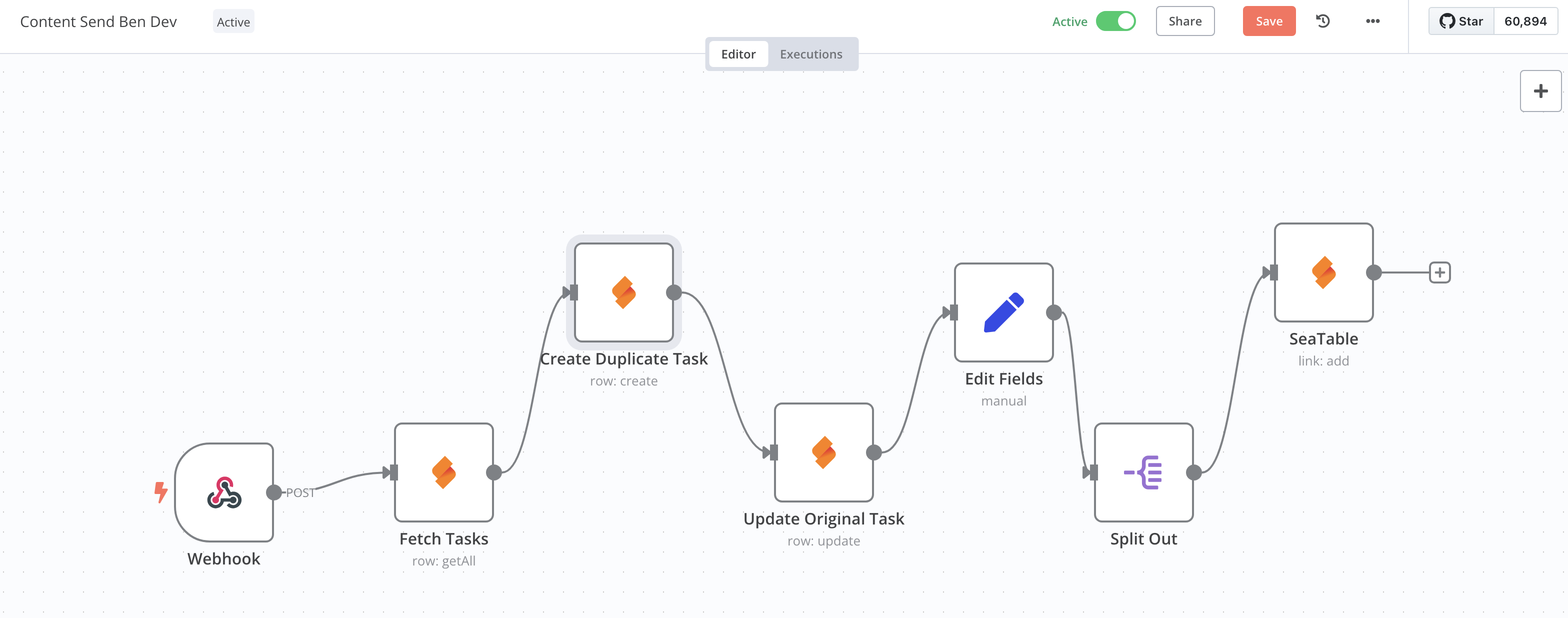

Hello. My current workflow inside n8n duplicates a basic row with generic fields perfectly. The problem I have is one of the fields I need duplicated is a file field.
At the bottom of the (Create Duplicate Task - create row) node, it has the following disclaimer:
“Hint: Link, files, images or digital signatures have to be added separately. These column types cannot be set with this node.”
So it gives a wonderful disclaimer, then doesn’t offer me any information on how to go about this the right way. And unfortunately, I can’t find any documentation on this.
So can anyone give me a general idea on the right way to go about duplicating a row that also includes a file field/column? I read something about the merge node in another thread, but I couldn’t really make heads or tails out of the discussion.

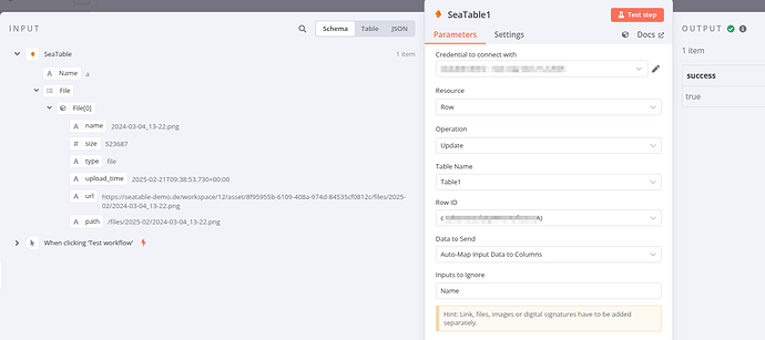

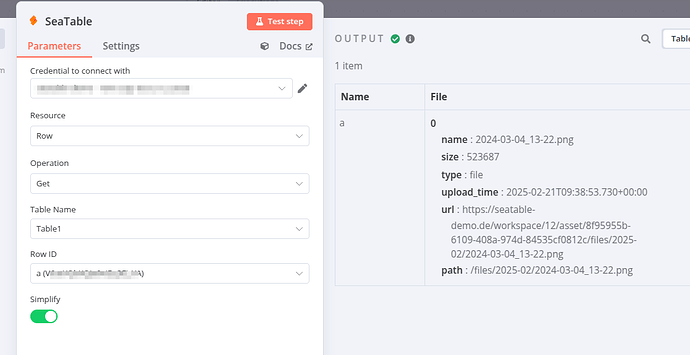

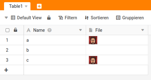

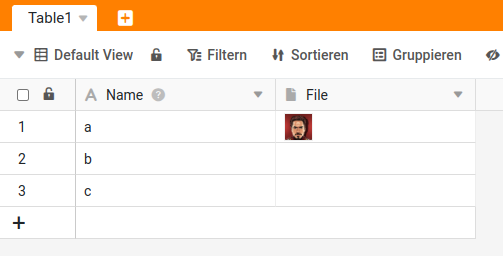

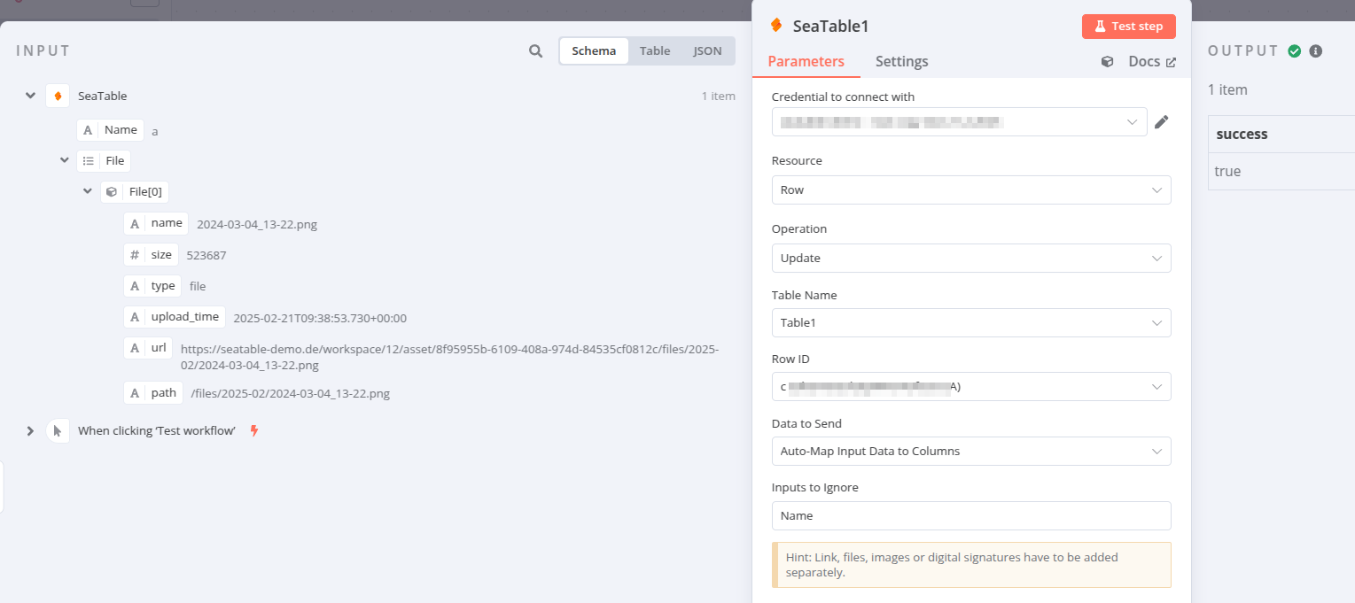

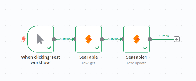

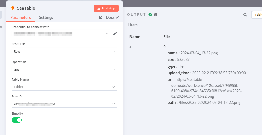

let me try to shed some light on that. The logik of a “file/image” column is like this:
  • SeaTable stores files/images in a separate location. In fact, a seafile server is taking the responsibility to store the data.
  • in the columns of the base, you only point to this file.
Therefore, if you want to copy a file/image column, you don’t have to upload a file again, you simply point to the file. Here is how you can do it:
Starting point
n8n workflow
After execution
Explanation
As you can see, I take the content of the “file-column” and use it to update another file-column.
Best regards
Hi Christoph. I actually had some other things wrong too in my workflow. So your short tutorial here with images helped me figure it all out and everything is working as expected now.
