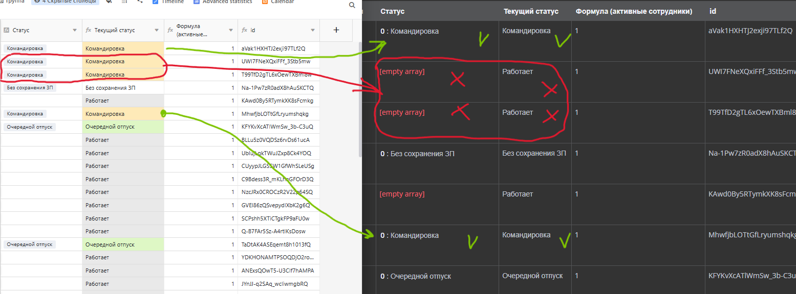

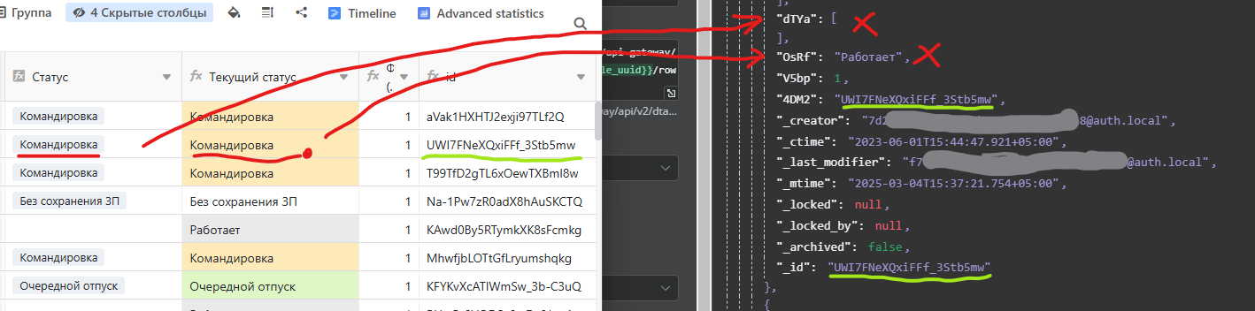

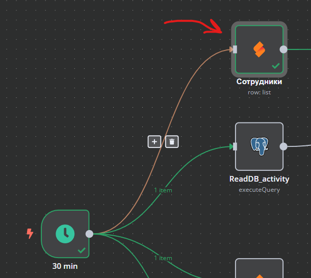

Hello everyone! I use SeaTable Self-Hosted version. v5.1. The problem is not in the SeaTable, but in the node n8n (i use Community node). This happens on the first node of the n8n pipeline — node outputs erroneous data.
The data in the other columns of these rows is updated normaly. Can you tell me what could be the reason?

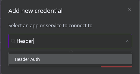

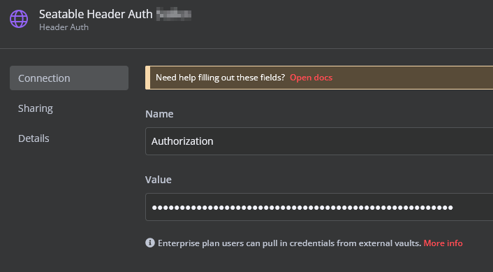

Create “Header Auth” credential with the API Token from the seatable GUI:
Give it a name, type “Authorization” into the “Name” field, and “Bearer ” into value (without <>" of course)

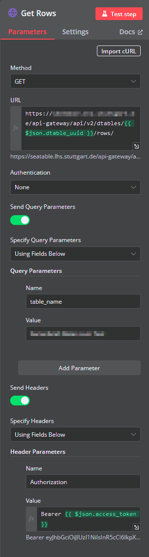

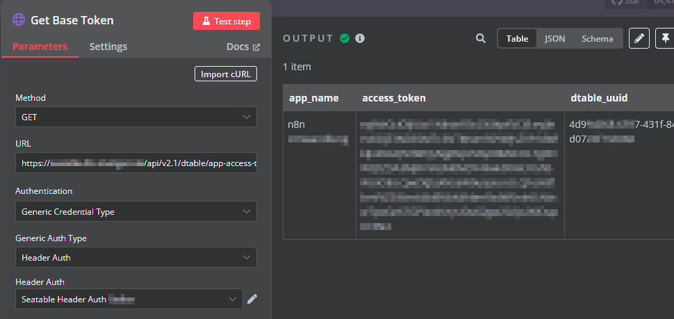

As your first node, to get a base token from your access token, create such a HTTP Request node:
That will return the access token for that session, and the unique ID of the table.
To retrieve all records for a table, you can use this information in the next HTTP Request. Note that you manually set the “Authorization” header in the header fields as an expression with the result access_token of the previous step, and use the dtable_uuid for form the URL.
In subsequent HTTP Requests, you cannot use “{{ $json.dtable_uuid }}” and “{{ $json.access_token }}”, but need a full reference to the “Get Base Session” node instead: “{{ $(‘Get Base Token’).item.json.access_token }}” and “{{ $(‘Get Base Token’).item.json.dtable_uuid }}”.

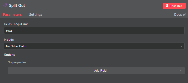

I almost forgot: You need to split the result to get single items. All in all more work than the custom seatable nodes, but more flexible.

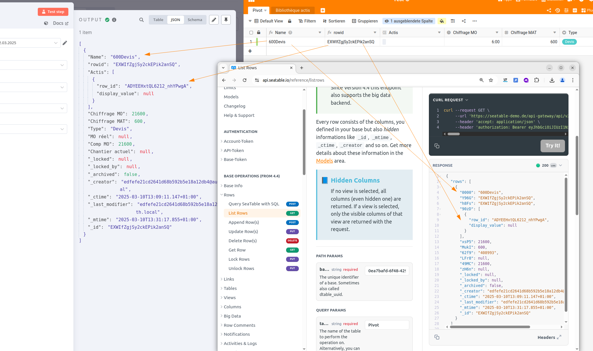

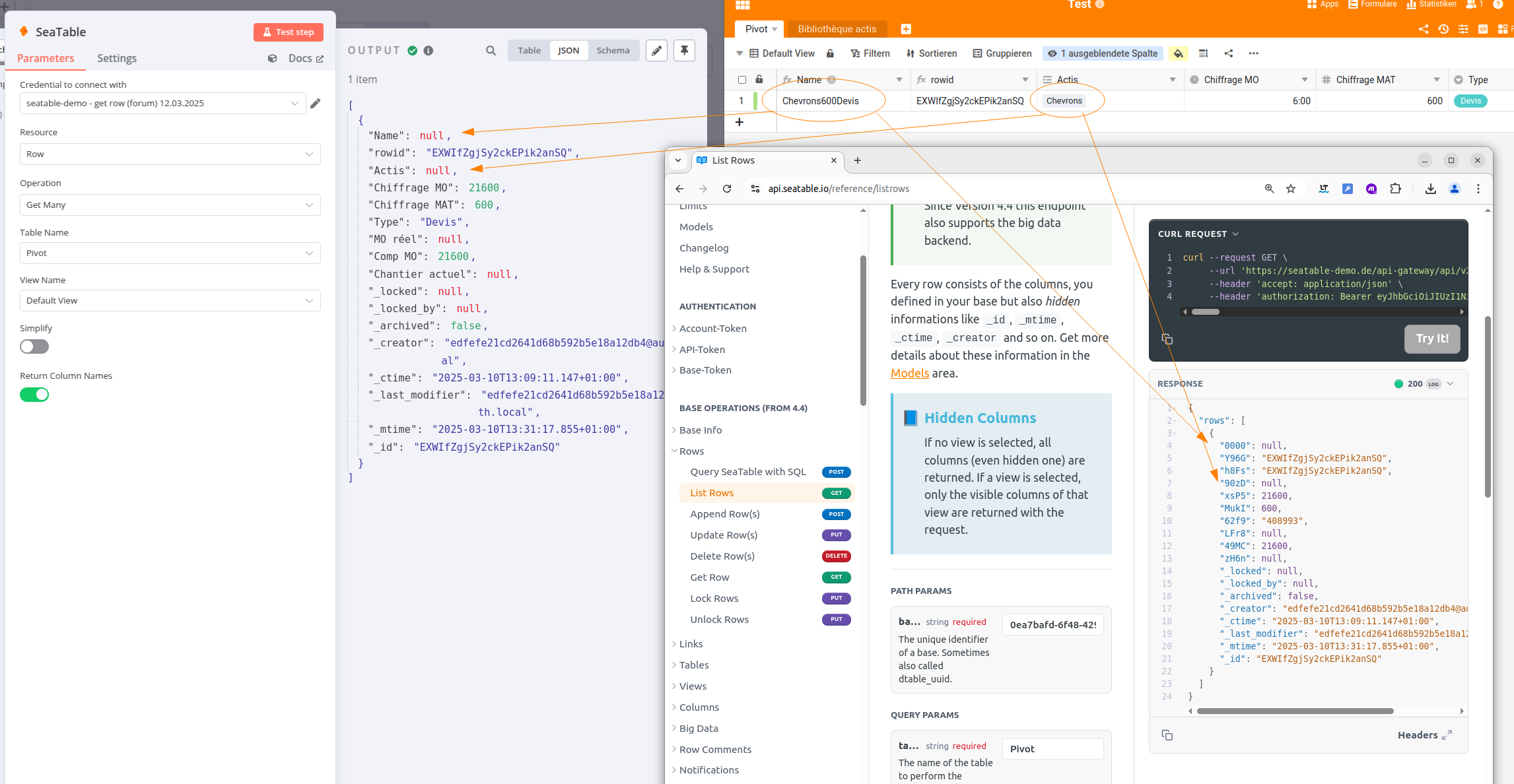

I have a table with several link and formula columns. While getting the content of the rows using list_rows, some of these formula and link columns are empty (returns None for python or null for api.seatable.io or n8n). While using @rdb’s script however (with context.current_row), I get the data for the considered row.
  • Python and JavaScript base.query functions and the SQL query plugin from inside SeaTable lacks the same data (the plugin returns the rows with these columns empty)
  • JavaScript base.getRows function returns the data correctly however
When exporting the table, data are present. While looking at the content.json inside my dtable export, I realized than the content for the first (0000) column (formula type) are either null or even not present, and the data from the other problematic column (link type) are completely missing to.

The data is being loaded incorrectly from the second table.

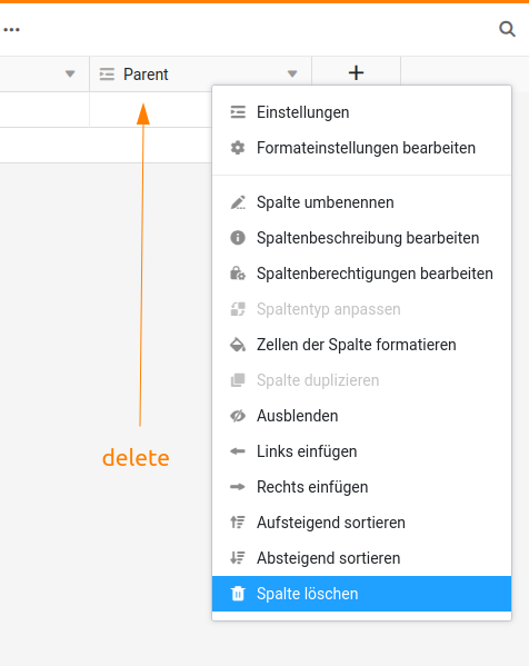

I analysed the problem and I found the root problem for the strange API behaviour.
What is the problem?
API, n8n and python return empty values for some of the link-columns or formula.

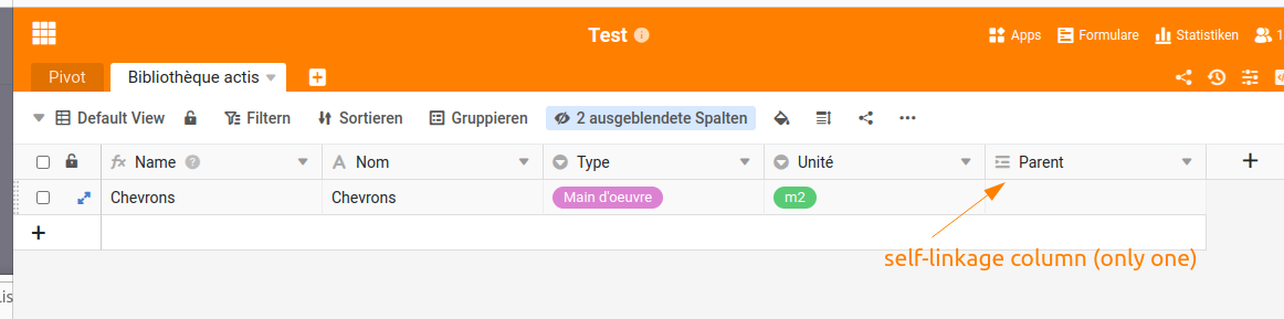

Root cause
With 5.2, the behaviour of the link-column was updated regarding links to the same table. If you link to the same table, there should be two columns created. As you can see here, “Parent” is linking to the same table, but there is only one column!
I don’t investigate further, but I assume this is also dependent of “formula” in the first column.
How to fix?
Delete the link column Parent.
Result
API, n8n and python now return the correct values
How to identify problematic columns?
Use the table relationship plugin to identify link columns, that link to the same table again. Then check, if there are two link columns.
