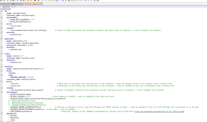

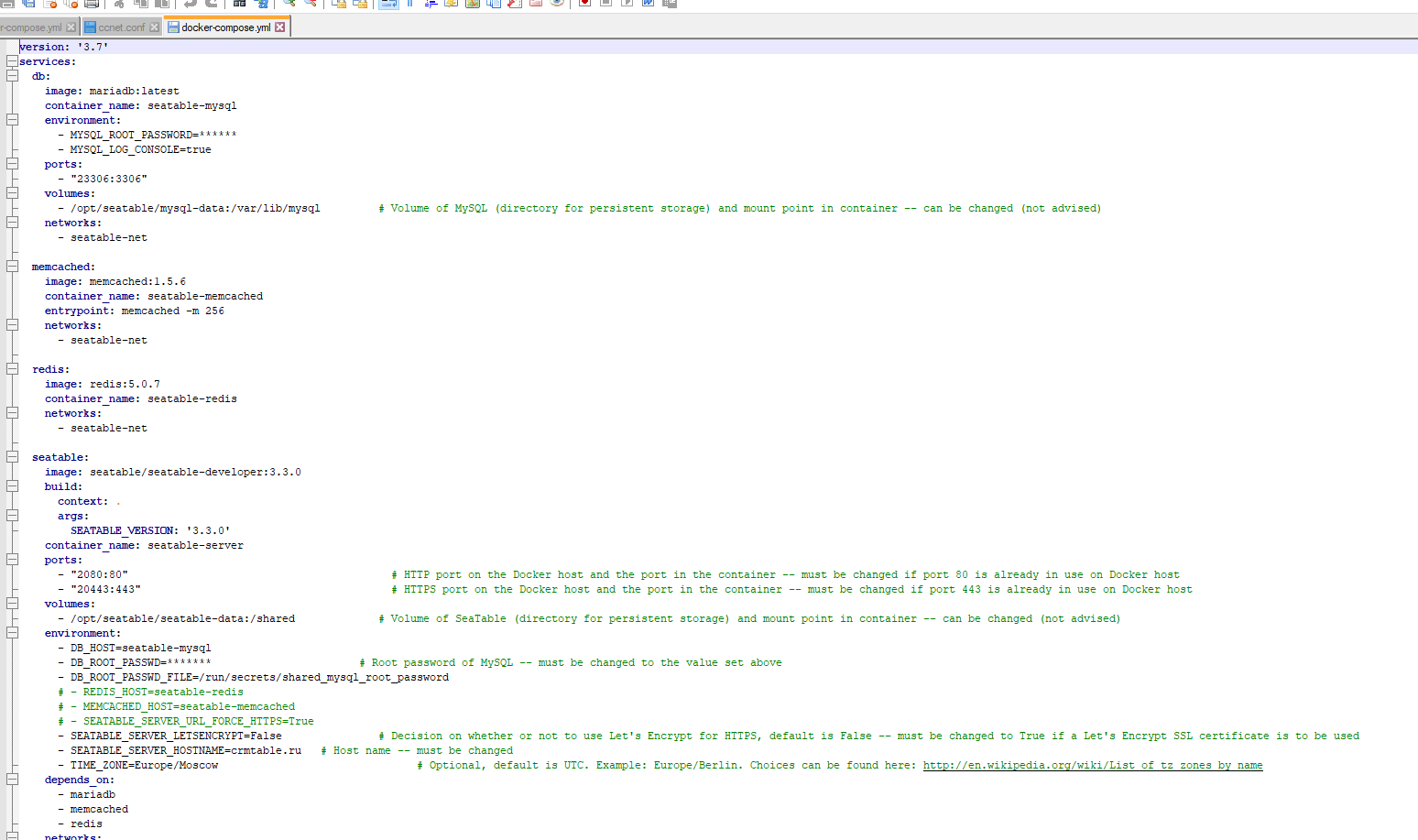

This is the relevant error message. It seems that you database container is called mariadb but in dtable-storage-server.conf you still have host = db. Change that and restart SeaTable.

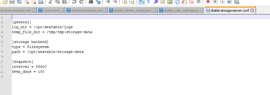

[general]
log_dir = /opt/seatable/logs
temp_file_dir = /tmp/tmp-storage-data
[storage backend]
type = filesystem
path = /opt/seatable/storage-data
[snapshot]
interval = 86400
keep_days = 180
this is what the config file looks like
Is it necessary to make changes to this file?

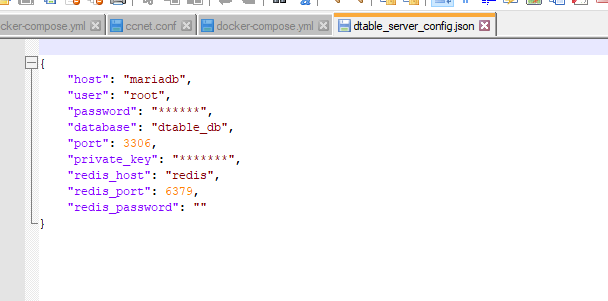

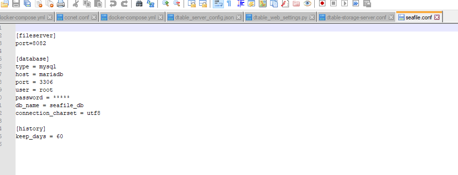

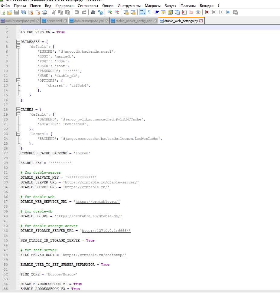

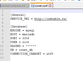

Please check the other configuration files and search for host = db.
I understand correctly what should be
host = mariadb ?
I don’t understand your question. Check the name of your mariadb container and then add this name to the configuration files. Otherwise SeaTable will not work.

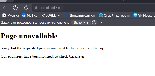

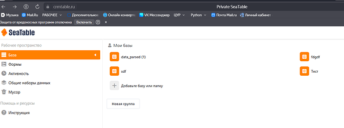

The problem is that when I want to open a newly created database, the error “Page unavailable” is displayed in the tab.
Sorry, but the requested page is unavailable due to a server hiccup.
Our engineers have been notified, so check back later."

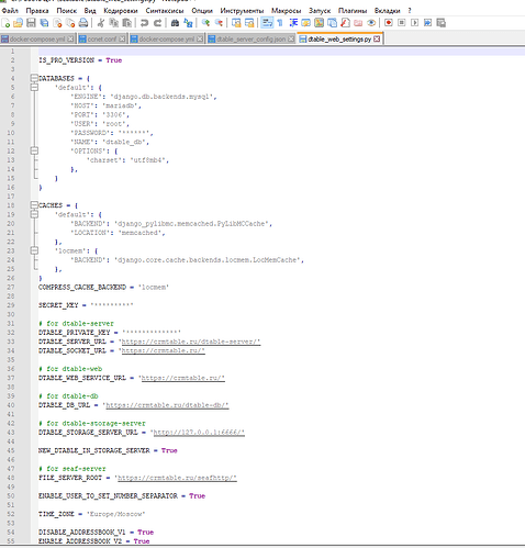

==> /opt/seatable-server/seatable/logs/dtable-db.log <==
[2025-02-27 08:28:11] [info] use the default log level: info
[2025-02-27 08:28:11] [fatal] Failed to setup dtable-db: private_key must be specified in the config file
[2025-02-27 08:28:42] [info] use the default log level: info
[2025-02-27 08:28:42] [fatal] Failed to setup dtable-db: private_key must be specified in the config file
[2025-02-27 08:29:13] [info] use the default log level: info
[2025-02-27 08:29:13] [fatal] Failed to setup dtable-db: private_key must be specified in the config file
[2025-02-27 08:29:44] [info] use the default log level: info
[2025-02-27 08:29:44] [fatal] Failed to setup dtable-db: private_key must be specified in the config file
[2025-02-27 08:30:15] [info] use the default log level: info
[2025-02-27 08:30:15] [fatal] Failed to setup dtable-db: private_key must be specified in the config file

From your logs, two problems are immediately visible:
  • [fatal] Failed to setup dtable-db: private_key must be specified in the config file
  • MySQLdb.ProgrammingError: (1146, “Table ‘dtable_db.dtable_seafile_connectors’ doesn’t exist”)
Therefore, you have two things to do:
  1. Make sure that the private_key is correct in the dtable_server_config.json and that the value is the same as in dtable_web_settings.py
  2. in your dtable_web_settings.py I assume that your mariadb configuration is wrong.
