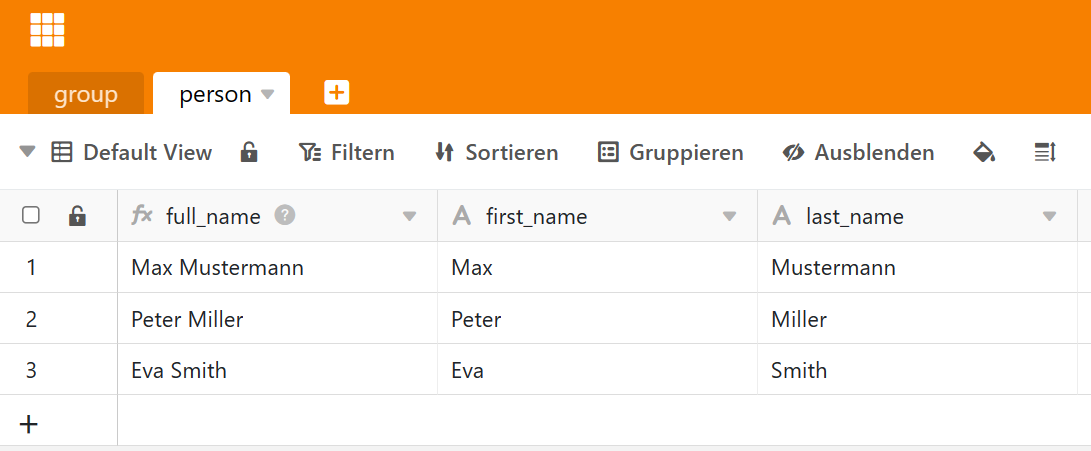

there seems to be a problem with the visibility of the first column in linkage views when the first column contains a formula. Look at the example:
I have a table with persons. The first column has a concatanation formula to combine first and last name:
