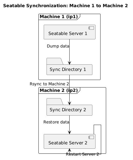

Thank you for these pointers. After some trial and error I think I found a working solution. Please find attached two scripts for anybody with a similar issue to start from. The first script seatable-push-sync.sh pushes from one server to its duplicate, using a local directory “seatable-sync” that is synced between both servers either way on each machine.
Once the synchronization is pushed from machine 1 to machine 2, on machine 2, I execute seatable-restore-sync.sh which loads the new data into seatable.
I noticed that this is not sufficient, because seatable keeps data in memory, so to be sure to have a clean situation on machine 2, I do immediately after the restore sync the following:
sudo docker compose down
sudo docker-compose up -d
The whole process is shown below, in both directions:
