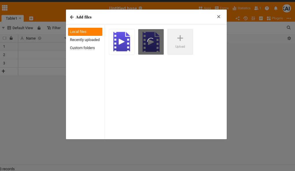

Here’s my trying it again showing a smaller file upload vs larger .mp4 file: https://zipline.kaiyerlab.com/u/hvbFXT.webm
When I try to upload a smaller file (e.g. a gif) it will upload fine. But a larger video file doesn’t upload, and no error no notice is shown either.
Error Messages:
No actual error messages show as you can see in the link provided of the screen recording. Also the console shows no errors either, it seems to just not understand the mp4 upload at all.
So update on this issue: Smaller videos will load.
Larger videos like 2GB + will not.
Edit: testing to see where it’s cutting off. I’ll try a 1GB video next.

Results: I tested this with
max_upload_size=5000
(for 5GB)
I then tried to upload a small video and it worked fine but larger videos 2GB still cannot upload and I get no error message. It just doesn’t do anything.

Yes, I restarted docker after. I even tried the /seatable.sh restart method nothing work to allow large file uploads.
I tried changing all the client_max_body_size in the nginx.conf to 5000M and that didn’t help either.
Still only smaller files upload, including smaller videos. The large video doesn’t though and no error in console it just literally behaves like nothing was uploaded still
No error messages in the server logs?
No, but I tried it in a different browser (I went from Brave to Chrome) and I now see this in the console even on smaller video upload fails:

The Analysis
In the default setup/configuration of SeaTable 5.2.7, there is no limitation in the upload file size by nginx, caddy or any SeaTable component.
The problem is the upload window, that SeaTable provides. It seems that this window is not capable to deal with files bigger than 1.5 GB.
The Workaround
But there is a workaround. Instead of using the upload window of the file column, you can upload a file via the “file mgmt”.
After the file is uploaded, you can assign the file to the file column.
I successful tested this approach with a 2.1 GB and 5 GB file.
Alternative
In general, I would say, that SeaTable is not optimized dealing with bigger files. SeaTable is good for structured data. Just one example: as soon as your base has assets bigger than 100MB, exporting your base becomes difficult…
I would recommend, that you upload the files somewhere else and just add the URL to the file in your base.
