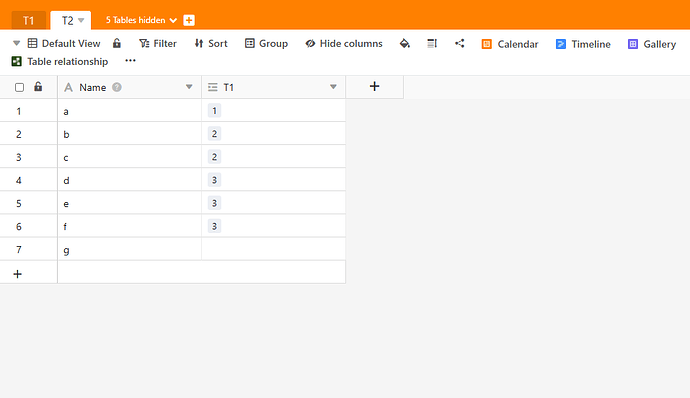

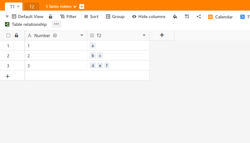

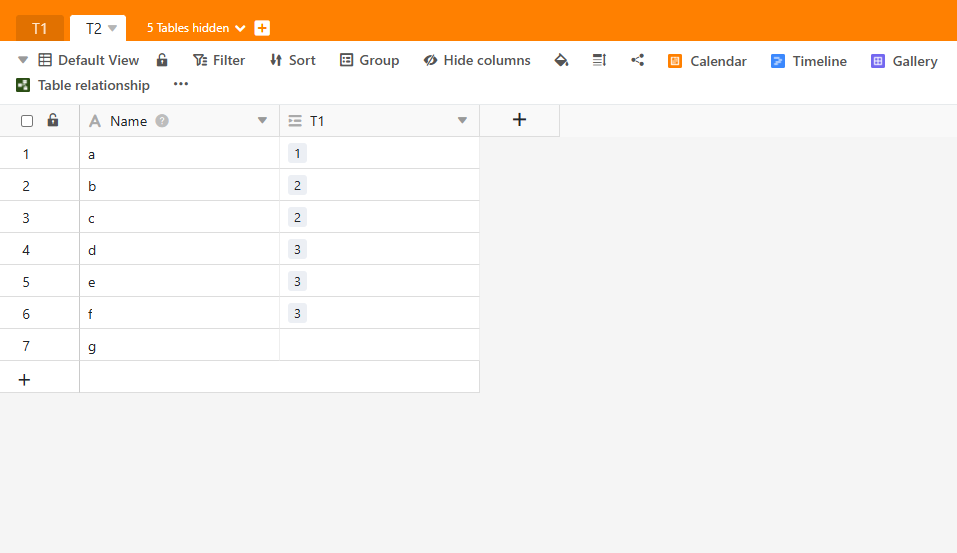

Hi @bennhatton, Thank you for the reminder. The JavaScript code I am trying to write is highly complex and constantly evolving. For this reason, I decided to prepare it in sections. The part I have shared here is related to the for loop, on which I have made every effort but have been unable to resolve.
Please take a look at the images below.
I want the code to perform the following task: It should review the records in Table T1 and identify the number present in each. If the number is 1, it should link to the first empty record in Table T2. If the number is 2, it should locate the first two empty records in Table T2 and link to them. And so on.
In essence, the code should read the number in Table T1 and, based on that number, link it to the corresponding number of unlinked records starting from the first available record in Table T2.
This task has consumed a significant amount of my time, but I have not been able to solve it. I would greatly appreciate your assistance in making this code work.
