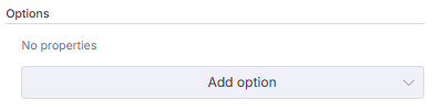

  • Finally: All this is not realizied in the GUI of the n8n Seatable nodes, therefore making them a source of frustration
    • I reverted to pure HTTP calls for the time being
    • If you should fix something in n8n, have a look at the default behaviour while at it
      • When you have no options set, the “simple” and “column name” options default to “true”
      • In the old nodes, the default was “false/true”
      • It’s a bit confusing, but manageble. However, a hint in the interface would be nice.
