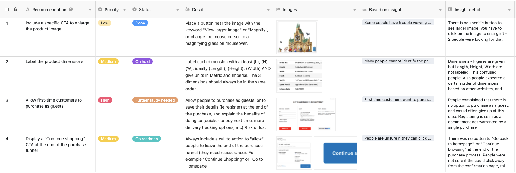

Lets see an example - Here I have 4 records:

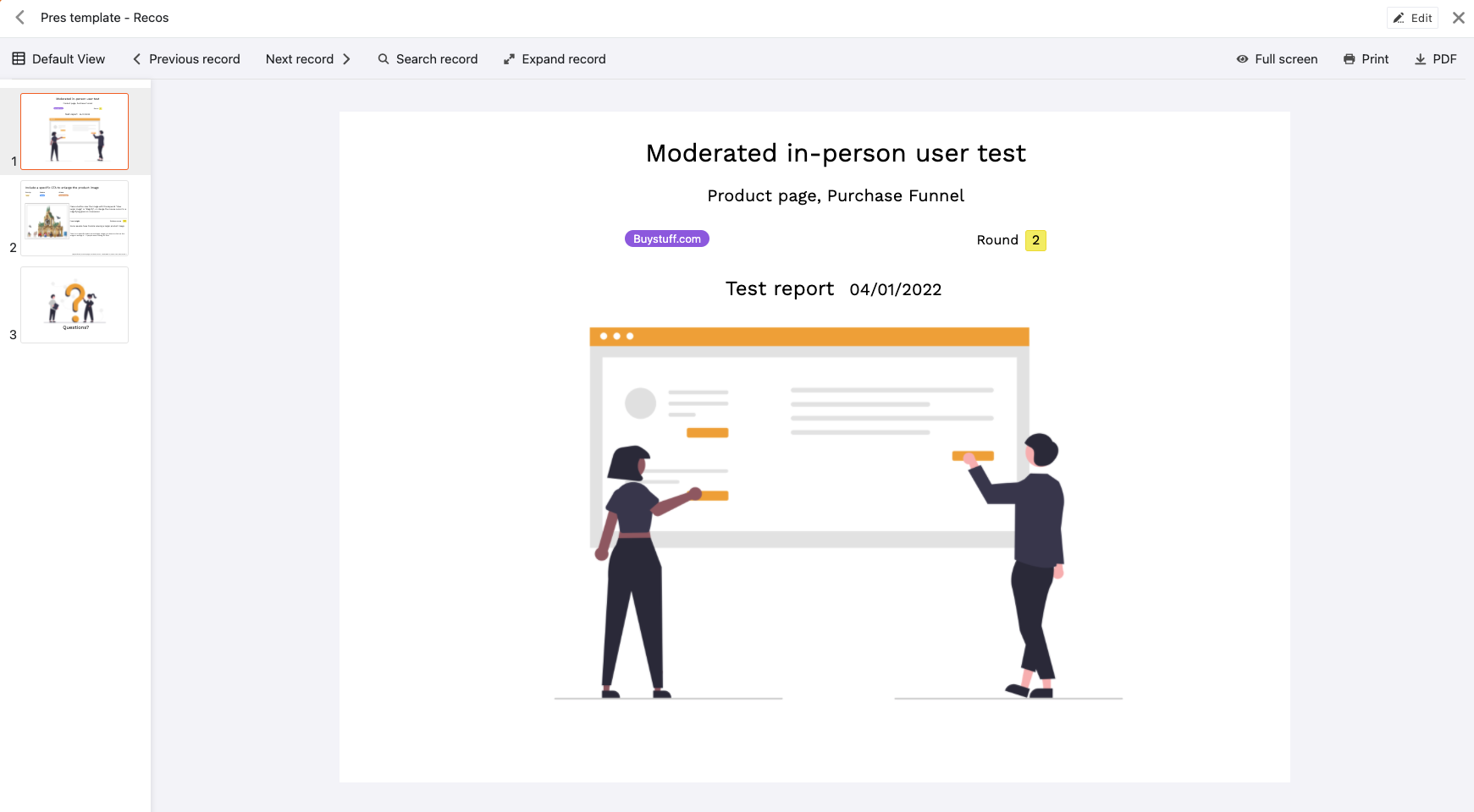

And I have a template with a cover page, a page for the records, and an end page:
So printing all records should result in a 6 page pdf - 1 cover page, 4 record pages, and 1 end page.

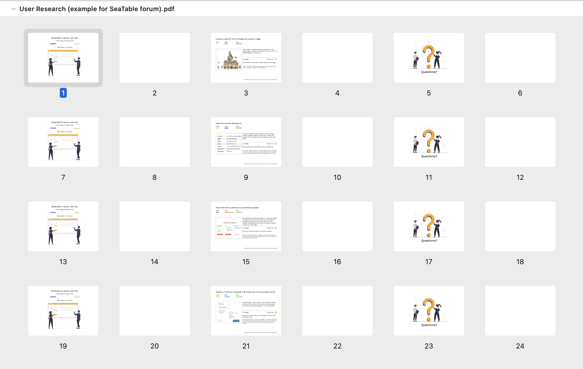

But what it produces is a 24 page pdf - 4 cover pages, 4 records, 4 end pages, and 12 blank pages:
The only work around is to manually exclude the blank pages from the print job, but this is very time consuming, and very annoying!
This is a known issue when your page is horizontal. The bug will be fixed in the next release 2.8.
Ah I see. Where can I see the list of known issues, and when is release 2.8 scheduled for?
I’ve checked using portrait layout, and as you say the blank pages are not there, but the cover page and end page are still repeated multiple times.
I’m afraid this is a mis-understanding of the feature. All pages in your page design template will be repeated by the number of records, no matter whether there are row references in the page.
