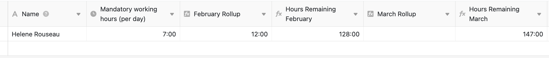

Okay so this is what I have managed. It doesn’t seem like the most efficient way to get to it so would still be interested in knowing if there is.
I have used the link formula RollUp function to add up all the worked hours calculated in the time tracking table for a specific month. E.g February Rollup, March Rollup and so on
I then created an “Hours Remaining for February” column with a formula: **(20 * {Mandatory working hours (per day)}) - {February Rollup}** and then do it for every month Feb, Mar, April and so on.
It works and is effective, but I am curious nonetheless if there was another way.

  • In order to limit the number of columns to create, you can eventually integrate the rollup calculation directly inside your Hours Remaining columns (see bellow). However, it is a very readable indicator, so it may be worth keeping it.
  • Depending on how long you want to use your tool, you may be confronted with the hard-coded number of working days in your formulas (each month of February does not necessarily have 20 working days). That’s why I wrote the following function (with the rollup mentioned above). It automatically calculates the number of working days between the 1st of February of the current year and the last day of the same month. You’ll notice that the three 2s in the formula correspond to the month of February. The formula can therefore easily be duplicated for the other months. If you want to keep the Rollup function, you can replace the second part rollup("Events","Worked time","sum","{Month}=2") by {February Rollup}
{Mandatory working hours (per day)}*networkdays(date(year(today()),2,1),eomonth(date(year(today()),2,1),0))-rollup("Events","Worked time","sum","{Month}=2")
  • depending on the particular cases you’ll have to deal with, you might want to use something more complex like a python script to calculate the theoretical mandatory working hours per month. I did this once to deal with both particular weekmasks due to part-time work and public holidays (it can become quite complex to determine which public holidays should be taken into account for which employees depending on their working days). It also helped me to easily handle the public holidays with variable dates that we have in France (Easter Monday, etc.)
