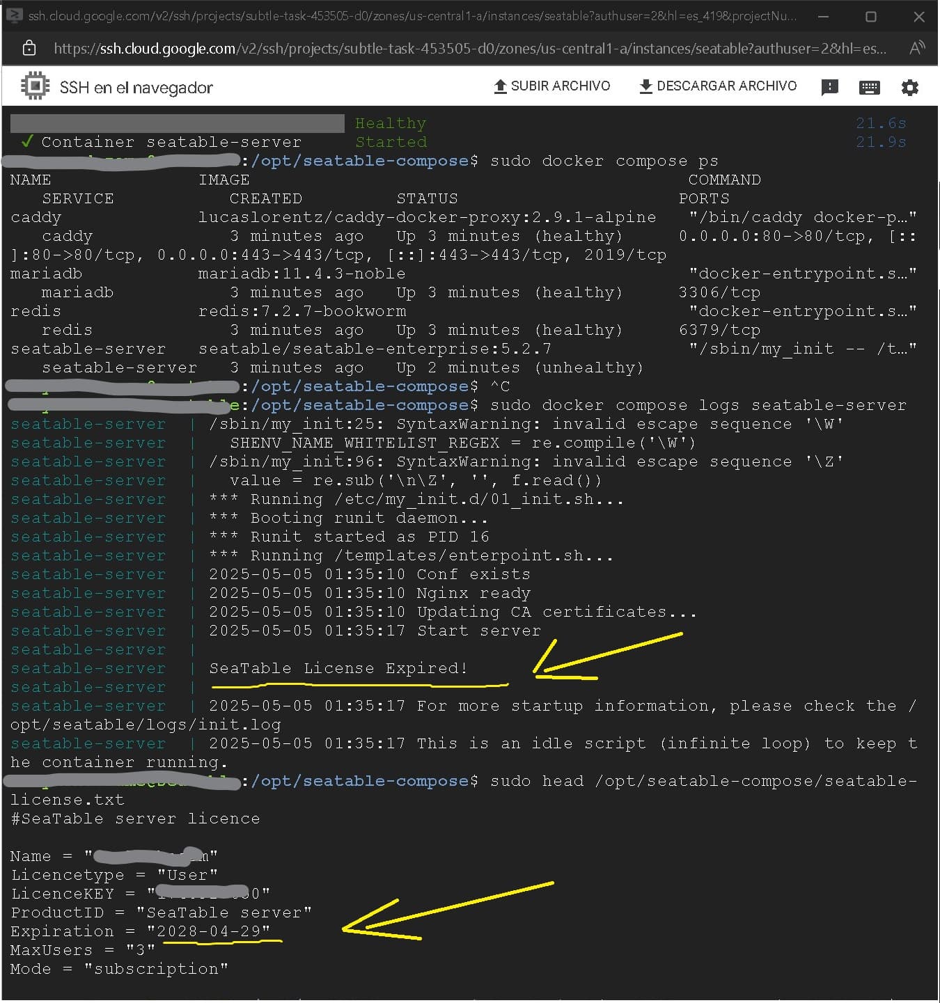

seatable-server    seatable/seatable-enterprise:latest        "/sbin/my_init -- /t…"   seatable-server     X minutes ago    Up X minutes (unhealthy)
Relevant messages from sudo docker compose logs seatable-server: (The log consistently ends like this after attempting startup, even with :latest image)
seatable-server  | *** Running /templates/enterpoint.sh...
seatable-server  | 2025-05-05 XX:XX:XX Conf exists
seatable-server  | 2025-05-05 XX:XX:XX Nginx ready
seatable-server  | 2025-05-05 XX:XX:XX Updating CA certificates...
seatable-server  | 2025-05-05 XX:XX:XX Start server
seatable-server  |
seatable-server  | SeaTable License Expired!
seatable-server  |
seatable-server  | 2025-05-05 XX:XX:XX For more startup information, please check the /opt/seatable/logs/init.log
seatable-server  | 2025-05-05 XX:XX:XX This is an idle script (infinite loop) to keep the container running.
Error snippet from /opt/seatable/logs/init.log (via docker exec):
requests.exceptions.ConnectionError: HTTPConnectionPool(host='127.0.0.1', port=8000): Max retries exceeded with url: /api2/ping/ (Caused by NewConnectionError('<urllib3.connection.HTTPConnection object at 0x...>: Failed to establish a new connection: [Errno 111] Connection refused'))

Despite the license file content showing Expiration = "2028-04-29", the server consistently fails to start with the misleading “License Expired!” message, apparently after failing to connect to its internal backend on port 8000. Other specific log files aren’t created.
Any ideas on what could be causing this or how to further diagnose why the internal backend isn’t starting?

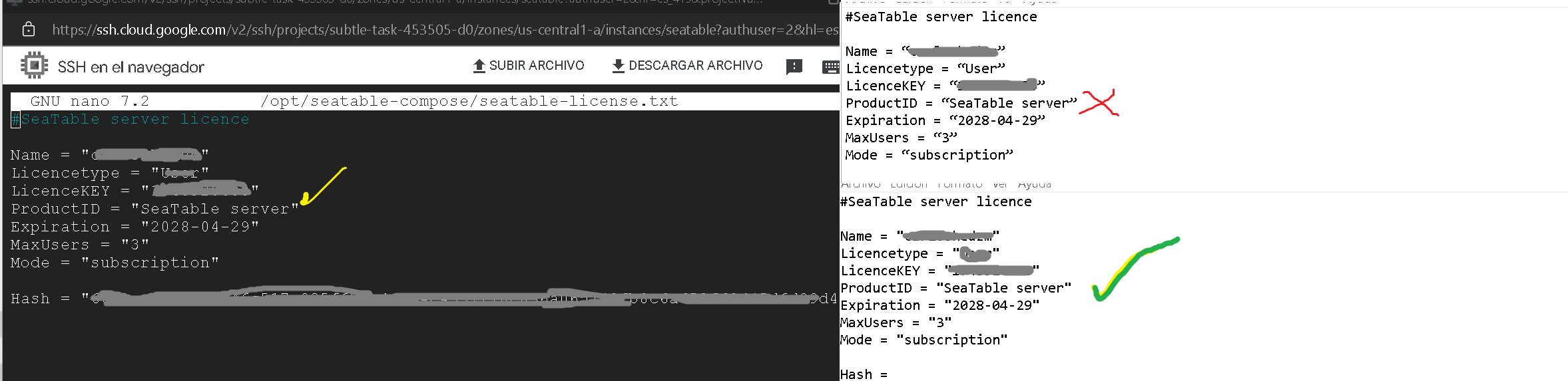

The root cause turned out to be quite subtle: I had received my new license content (which was valid until 2028) as text pasted in a reply here on the forum. When I copied and pasted that text directly into my seatable-license.txt file using nano, it included typographic/curly quotes (“”) instead of standard straight quotes (").
These non-standard quotes caused parsing issues for SeaTable’s internal scripts when reading the seatable-license.txt file. Specifically, it led to an internal date: invalid date '...' error when trying to validate the Expiration value because the script couldn’t parse the date correctly with the surrounding (curly) quotes. This failure then triggered the misleading SeaTable License Expired! message and caused the seatable-server container to remain unhealthy.
The Solution:
  1. I edited /opt/seatable-compose/seatable-license.txt again using sudo nano.
  2. I located the Expiration = “YYYY-MM-DD” line.
  3. I completely removed the quotes surrounding the date value, leaving the line as Expiration = YYYY-MM-DD.
  4. Saved the file.
  5. Restarted the stack using sudo docker compose down && sudo docker compose up -d.
After removing the quotes from the date value, the internal script could parse it correctly, the misleading “Expired” error disappeared, and the seatable-server container started successfully and became healthy. The instance is now accessible!
