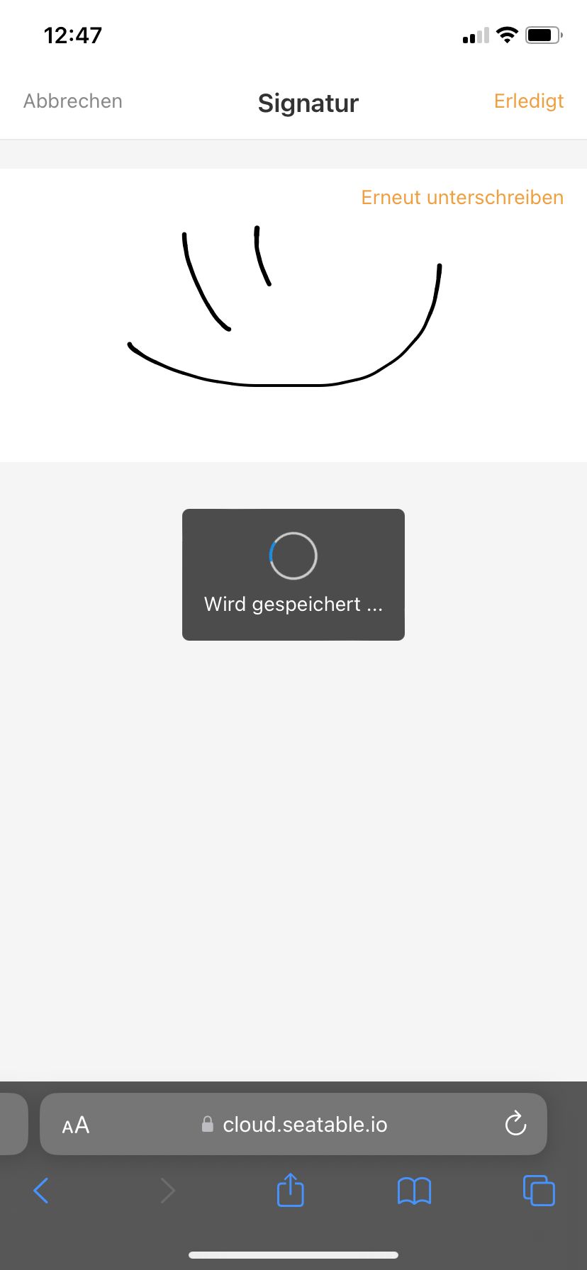

I have a table with a signature column with a form for it. Now when I want to fill out this form on my phone and I give my signature, it just says, “Saving…” and nothing more happens. I can’t come back and submit the form. What can I do there? Is this a Seatable bug?
I have an iPhone 11 with IOS 16.0.2. And I tested it on the Safari, Chrome, Edge and the Google app
That’s what my phone shows after creating a signature:

Hi fsa,
I just tried it again, and it still hangs on the save animation. I’ve updated my phone to the latest IOS and the same thing happens. I don’t know what to do.

Edited: I noticed that the button on the iPad (where the form works) says something different from the button on the phone (where it doesn’t work).
I just found out how to recreate the problem on the PC. Depending on the window width, the form changes due to the responsive design. On a wider window, the button for saving the signature says “Save” and on the narrower window it says “Done”. And by inspecting the buttons, you see that both buttons call different functions. Could this be the problem?
In this video, you see the different buttons and functions:

I also have this problem. On a Samsung S23 phone using the Samsung Browser when I sign holding it in lanscape orientation it works, and the signatiure is stored in the Base. In potrait modus it hangs on “Wird gespeichert”.
But still, on a iPhone SE the Landscape orientation does not work. Might the display resolution be the reason?
We have received similar error reports from other users. We are investigating the issue and will provide a fix in a future release.

It is likely caused by anonymous users can’t work with signature field in version 4.0. This will be fixed in version 4.1.
Good morning. Just my 2 cents to the issue: On my Galaxy tab 6 in secufox browser, i also have the issue, that it would stop while saving. I have a form, with a sign field. If I manually load the page as “desktop page” through firefox options, it works. Same, if I change orientation from portait to landscape by turning the device, before I fill in the signature.
Obvious reason: The change in format, as in landscape, there is another control used for the signature, than for portrait orientation.
