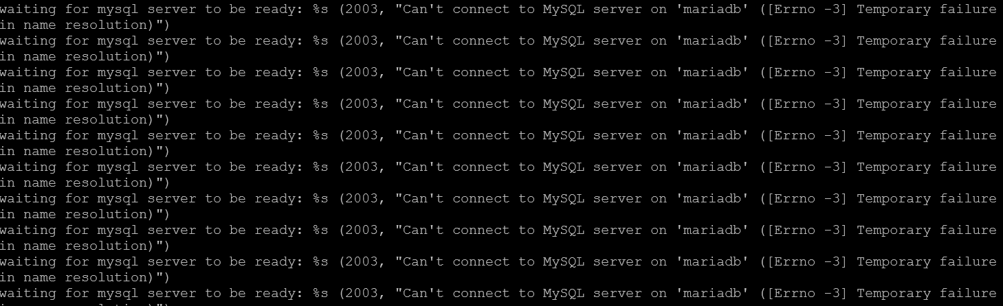

As I looked at the logs I would say that is correct, it is showing issues with DB. I did not place DB_HOST in the .env as I did not see it in documentation anywhere. I presume that this has to be setup on Python Pipeline to point to SeaTable server were DB is ?
PS: Logs from docker:

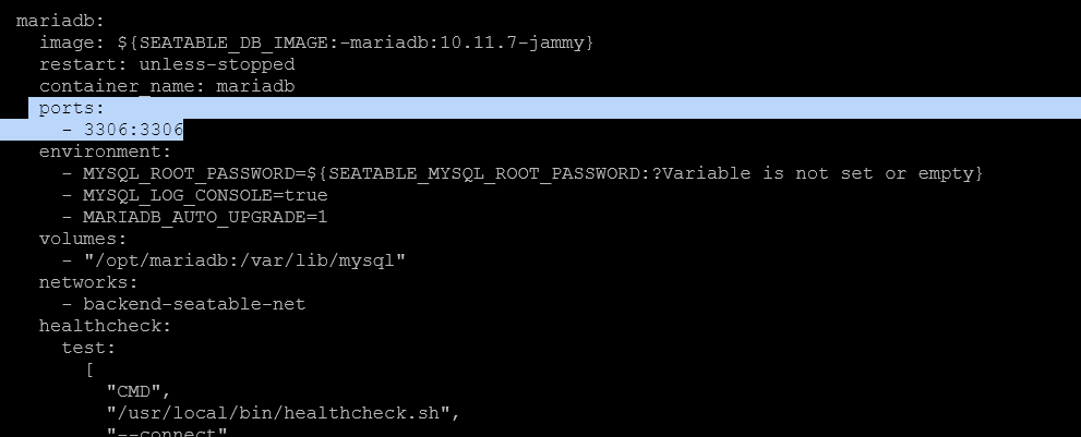

I did adjustments on seatable-server.yml and exposed MariaDB.
Tested from Python Pipeline server and through telnet its reachable on port 3306.
How do I configure now Python Pipeline to connect to it? Should I place DNS of my SeaTable server in DB_HOST that I place in .env file or ? How does this work ?
