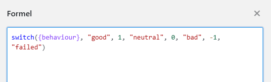

I tried the switch formula to get from a select field to a numerical value for further processing.
But, it fails when i want to map a value to 0. Why?
Reproduce
Make a column with a selection. I.E. “good”, “neutral”, “bad”
I want to map “good”->1, “neutral” ->0, “bad” → -1
so i do this

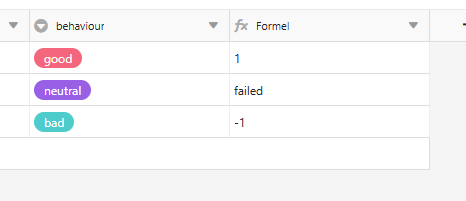

switch({behaviour}, "good", 1, "neutral", 0, "bad",-1, "failed")
For good and bad, it works, for neutral, i get failed.
This seems to be wrong

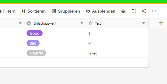

We retested it on
{“version”:“5.2.7”,“edition”:“enterprise edition”}
Sadly same Result
Workaround with explicit ifs() works as expected

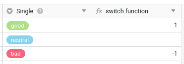

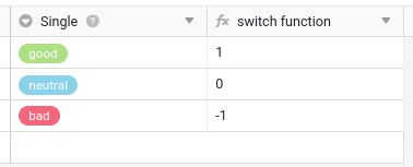

I cannot reproduce the issue.
This is the result when using switch() with strings:
This is the result when using switch() with integers:
You could argue that the cell should display “0”, but an empty cell and the value zero are basically the same. They behave the same when using them in formulas.

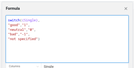

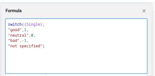

This said, I see another problem in your formula: The result type in a formula column is either string or number (or date or date-time, …). You are mixing number in string in your formula.

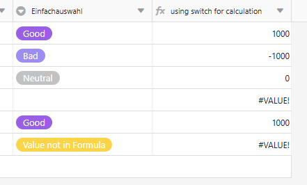

Tested it as part of a calculation, and it seems to work with the paranthesis.
switch({Einfachauswahl}, “Good”, “1”, “Neutral”, “0”, “Bad”, “-1”, “failed”) * 100 ← works
switch({Einfachauswahl}, “Good”,1, “Neutral”, 0, “Bad”, -1, “failed”) * 100 ← does not work
From my point of view, this is a cosmetic issue. But it is an issue because it is inconsistent with the way other formulas work. I created a ticket.

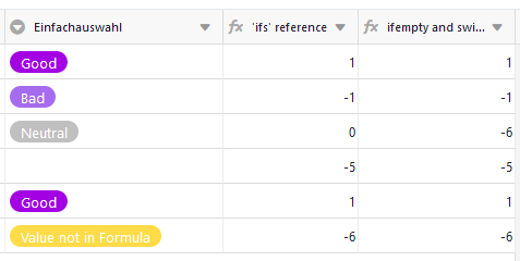

Here’s my test:
Intended behaviour:
  • All consistent numerical outputs
  • “Neutral” returns zero
  • Empty cell returns -5
  • Untreated values return -6
  • Good = 1, Bad = -1
Reference formula with ifs
ifs(
isempty("Einfachauswahl"),-5,
{Einfachauswahl}="Good", 1,
{Einfachauswahl}="Neutral", 0,
{Einfachauswahl}="Bad", -1,
True(),-6
The same with switch(), making sure that the output in consistently the integer type:
switch(
if(isempty("Einfachauswahl"),"dummyentryforempty",{Einfachauswahl}),
"Good", 1,
"Neutral", 0,
"Bad", -1,
"dummyentryforempty",-5,
-6
My conclusion: The switch result “0” crashes into the “default” option => Bug?
The whole analysis was somewhat muddled by the fact that @sango used a “string” default value, which resulted in the value not being displayed because the detected column type was “number”.
Which is easily tested with this formula
switch({Einfachauswahl},"Good", 1,
"Neutral", 0,
"Bad", -1,
"Default") & " forced into String"
