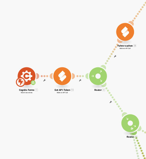

I’ll post a few screenshots to illustrate the process.
In my example I use Cognito Forms as a form server. Incoming form posts are forwarded to this make.com scenario.
In the first step you get the dtable_uuid, which you get via API call /api/v2.1/dtable/app-access-token/.
In the second step, you then execute the API call with the SQL query /dtable-db/api/v1/query/{{16.body.dtable_uuuid}}/, where {{16.body.dtable_uuid}} is the dtable_uuuid from the first call.

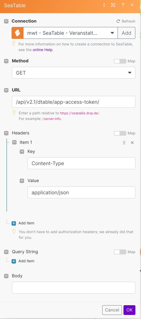

Thank you so much for you help. Unfortunately, I seem to be falling at the first hurdle. I copied the /api/v2.1/dtable/app-access-token/ command and used the “Make an API Call” module to make athe request but get “permission denied”. I am connected to SeaTable as I use the connection for other reasons.
The way I described above is actually the right one. However, since SeaTable 4.0, API access via the API call module of make.com does not seem to work reliably.

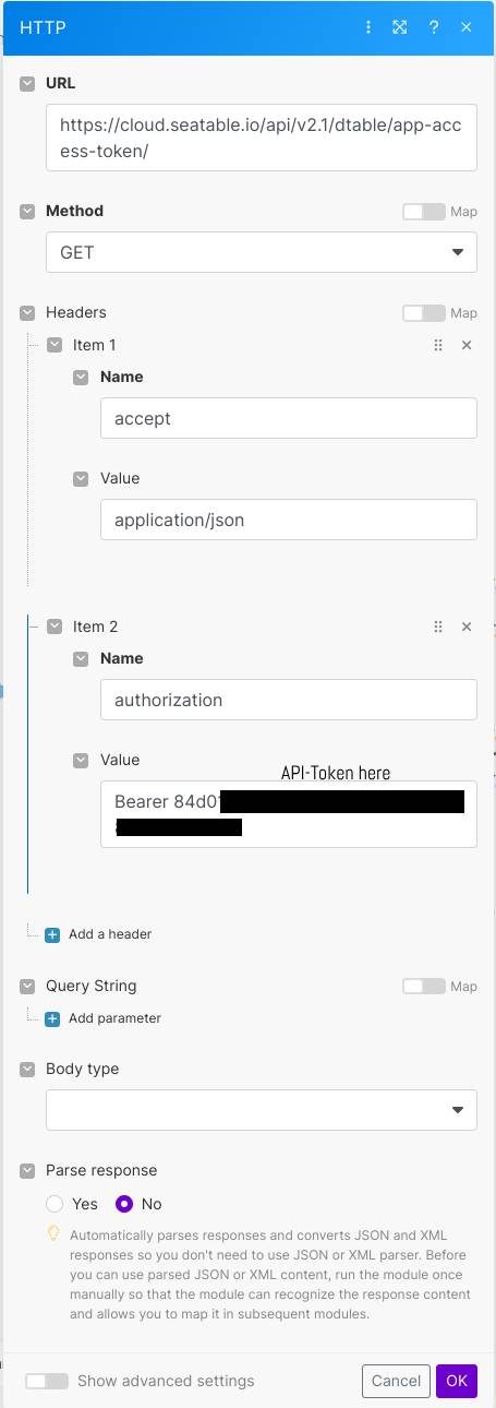

Fortunately, there is a workaround for everything. In this case, we simply make an HTTP call from make.com with the correct parameters (basically as if we were making the call via curl).
Here are the screenshots of the workaround.
Screenshot 2023-11-17 17.55.13
In the HTTP call, we must enter the complete URL to the Seatable server. In my example, this is the Seatable server itself.
Of the two header items, the second is the most important: the API token of the respective Seatable base must be specified after the word “Bearer”.
The result of this call is a JSON data element. This is prepared for further use with the make.com JSON module.
Addendum: You can save yourself the trouble by parsing the response of the HTTP call as JSON using the option provided (see screenshot above at the end).
